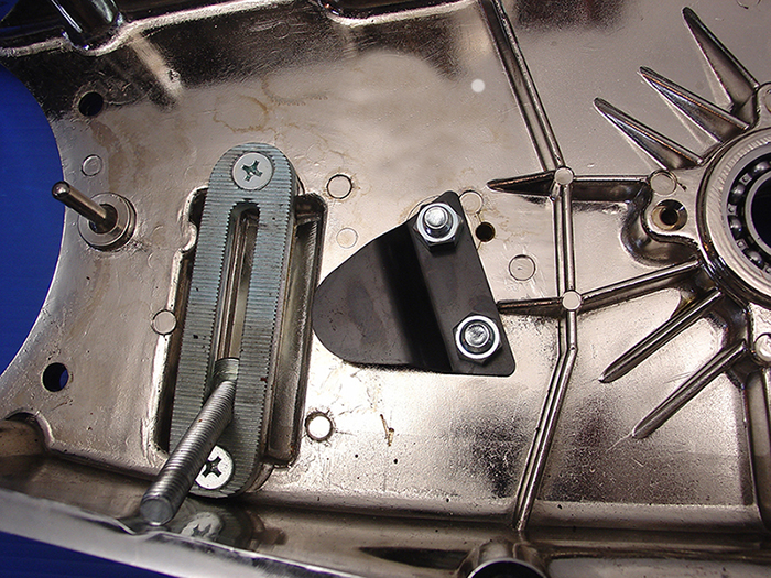

    If indeed you're running the primary sealed (As in the Evo design) there is this gizmo that helps the clutch contend with the oil ...
    Primary baffle plate helps keep oil out of clutch pack.
    VT No 12-1519
