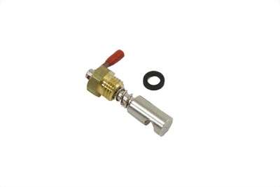

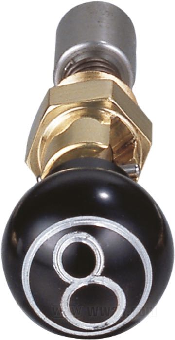

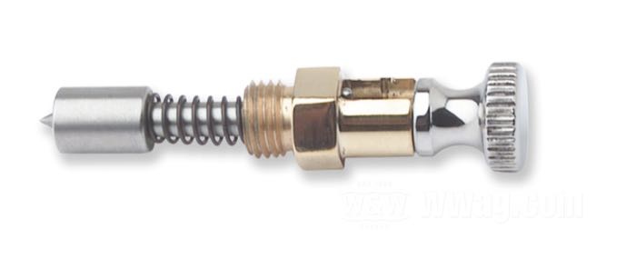

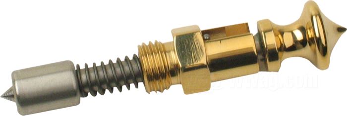

    The owner of this Super-B wants one too ..
    Going to need one of these for the "B" carb ...
    Chrome carburetor enrichment is 3 position with pike knob ..
    (Maybe two ??)
    ____________________________________________
    VT No 35-0371 (NO LONGER AVAILABLE)
    These are ...
  10. #10

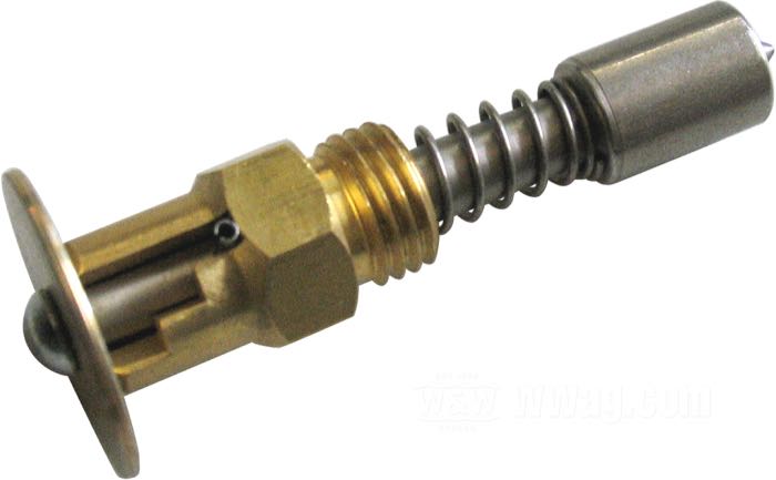

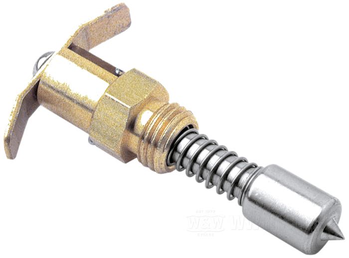

    And the S&S og ....
  11. #11
    Senior Member
    Get Adobe Flash player
    Join Date
    Apr 2013
    Posts
    9,825
    Default
    They all work. I've a couple of the VT pic style "notched" versions from whoever it was that made them first and some S&S (I trim the "wings" so there's less mass to vibrate but never saw any extra wear with stock, it was just a free precaution done back in the Cenozoic era).

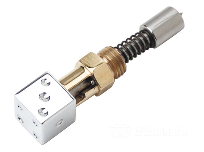

    Default
    There's more than you can shake a stick at ...
    Kinda like walking into a Baskin-Robbins ....
