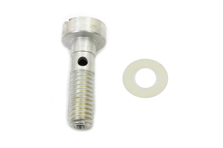

    Yeah it is mate, not sure if the hole in the shank of the bolt lines up with gallery when done up though

    You may have to switch to one of the aluminum washers with o-ring molded on the ID. Like the ones H-D uses on their brake system banjo bolts.
    Jim
  11. #11
    Default
    I think i know the ones you're talking about, thanks jim! Just a bit strange as it never used to leak before i rebuilt the motor

    I had the same problem. Fixed with a new copper washer
