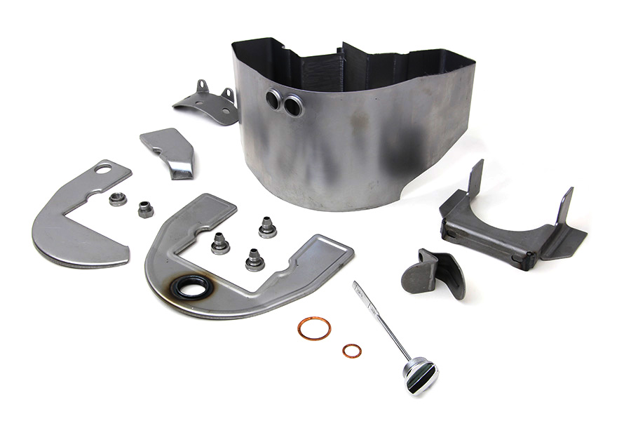

    If you're up for some custom fitting work, this kit would be give you the base line to start from ..
    $100 for what you see ..

    The easy way .....
    Room for a Big Battery to boot .. !!
    This tank was my pick for the 96" Turbo 48 Lookalike scooter I built a few years back ..
    ( ^^ Not a real Panhead, be a Wolf in sheep's Clothing )

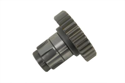

    Compiling a order for parts and thought I would mention the parts needed for changing from belt drive to chain drive ..
    5th gear made by Andrews ^^
    Sprocket tooth count available from 22T to 25T your pick ..
    I have the Jim's tooling to R&R the gear ..

    If needed, say the word and I'll make it so ...
