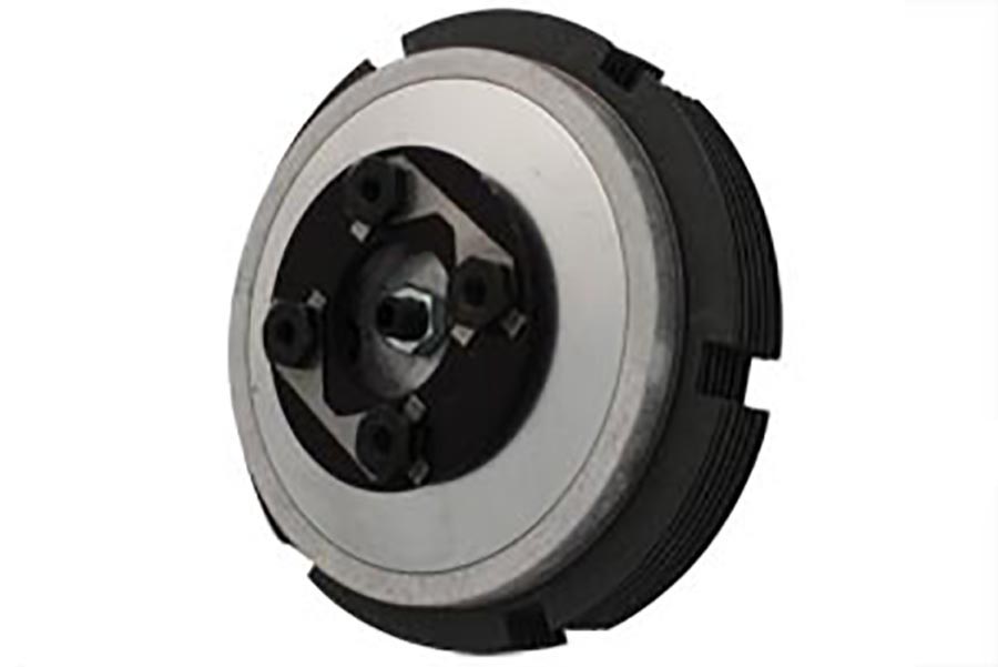

    Wanna get rid of those coil springs and up-grade your clutch to a belleville ... ??
    VT No: 18-0540
    Diaphragm clutch spring pressure plate includes 5-stud clutch, diaphragm spring, pressure plate, rollers, adjustment screw, and stud nuts.
    Updates old style coil spring clutch to new style diaphragm clutch for positive clutch engagement.
    Fits:
    Special application with open or closed primaries

    Lets muddy the water some more ..... Want Too ??
    Install a Pro-Clutch and never again look back to the past...
    (Might turn into a pillar of salt) ...
    Kit includes a clutch hub, friction and steel discs, pressure plate, clutch plates, hardware and instructions.
    Converts old style clutch packs to smooth modern diaphragm spring function. A sturdy double row ball bearing replaces the stock caged bearings, eliminating clutch grab and clutch hub side movement. Requires less hand effort at the handlebar, delivering smooth hand control. For use with belt or chain drive models with wet or dry clutch.
    Dang GOOD clutch: (40 % more surface area then OE)
