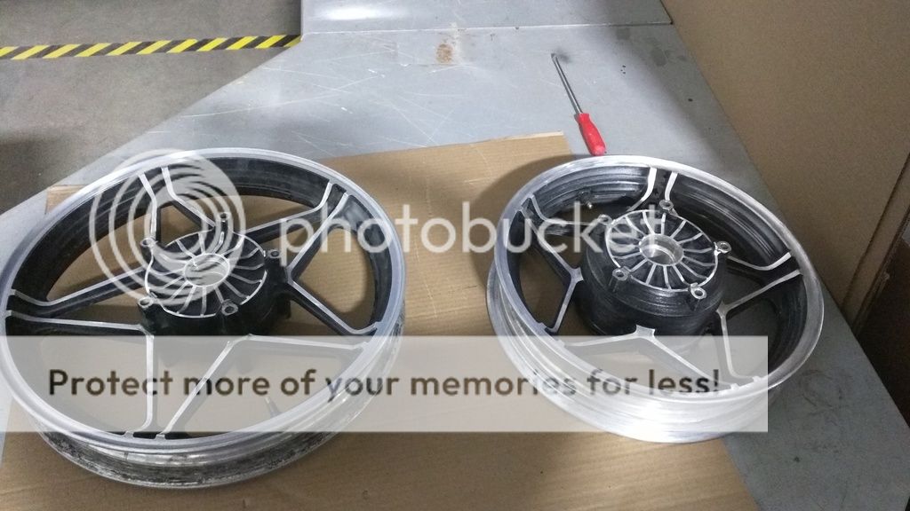

    Also started sanding my rims. Holy Christ is that powder coat hard to get at in most areas. I just realized I havnt taken a pic of the wheels I'll be using so I'll shoot those tomorrow too. Anyways I figure if I can ruff up the surface e enough and get them clean I should be able to primer over that. Shouldn't need to get all of the powder coat off to paint over.

ID:	69205Heres what style rim I'm using. The silver accents are going to be painted copper and the rest of the rim will be texture black. And apparently photobucket hath decreed I fuck myself...

    I a appreciate the encouragement. I havnt had a chance to enjoy this machine yet. Anyways here's where I'm at.
    As I said before the silver bits were gonna be copper so I sprayed copper as the base and started taping to shoot the black.
