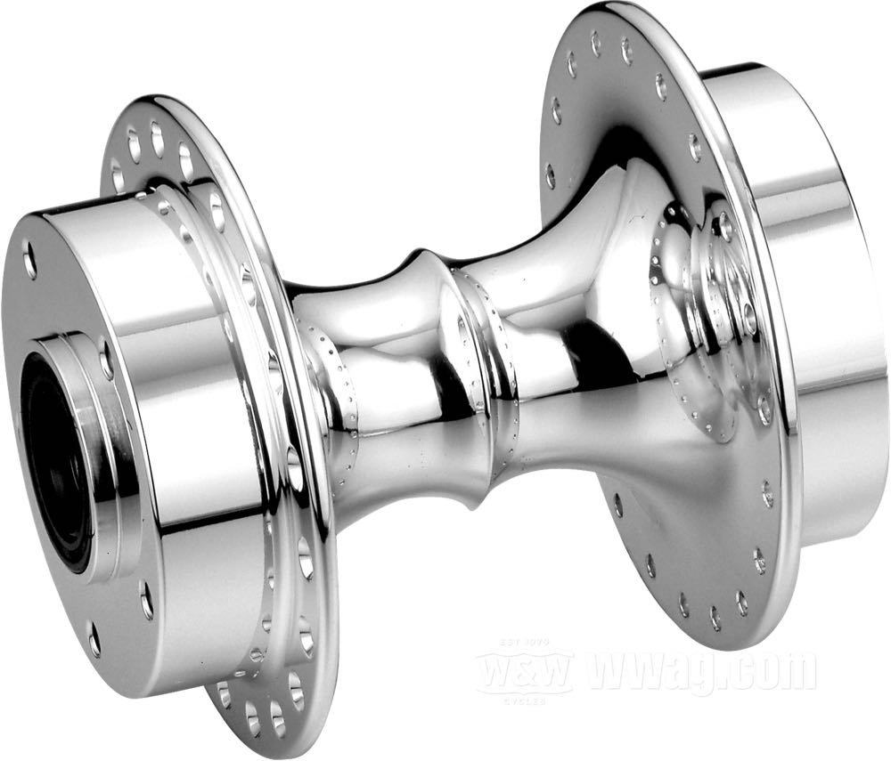

$2,340.00 ... It's up there ...:eek:
Throw in a custom hub ..
http://www.wwag.com/step3/1000jpg/10397.jpg

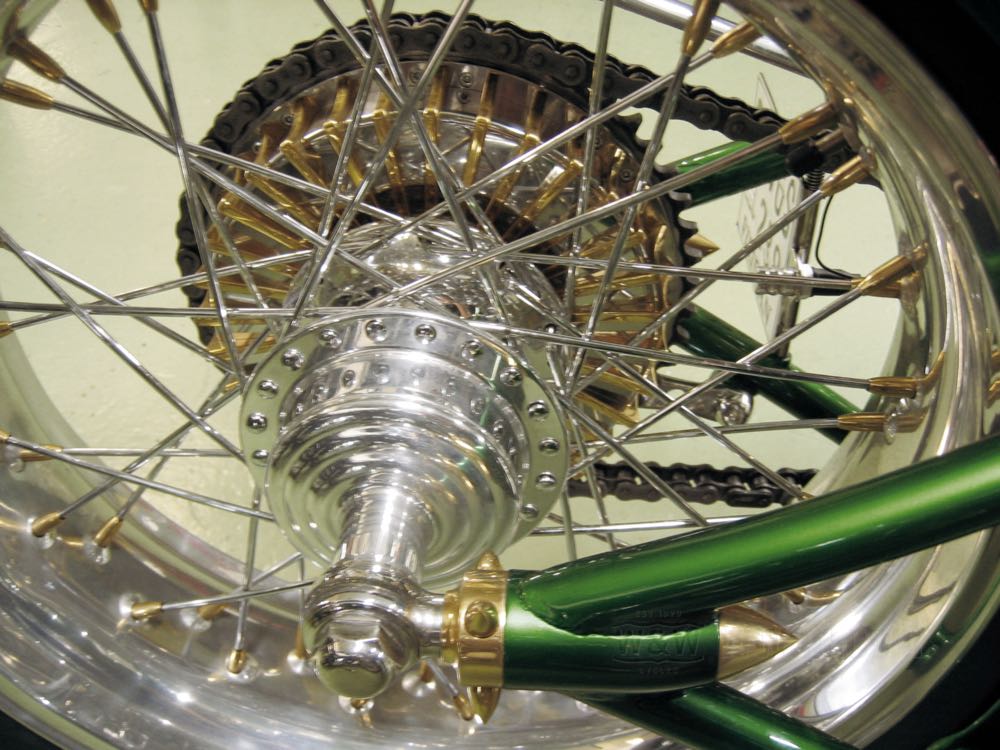

And time to sell the farm !!
http://www.wwag.com/step3/1000jpg/46063.jpg
Lot of eye candy back there ...

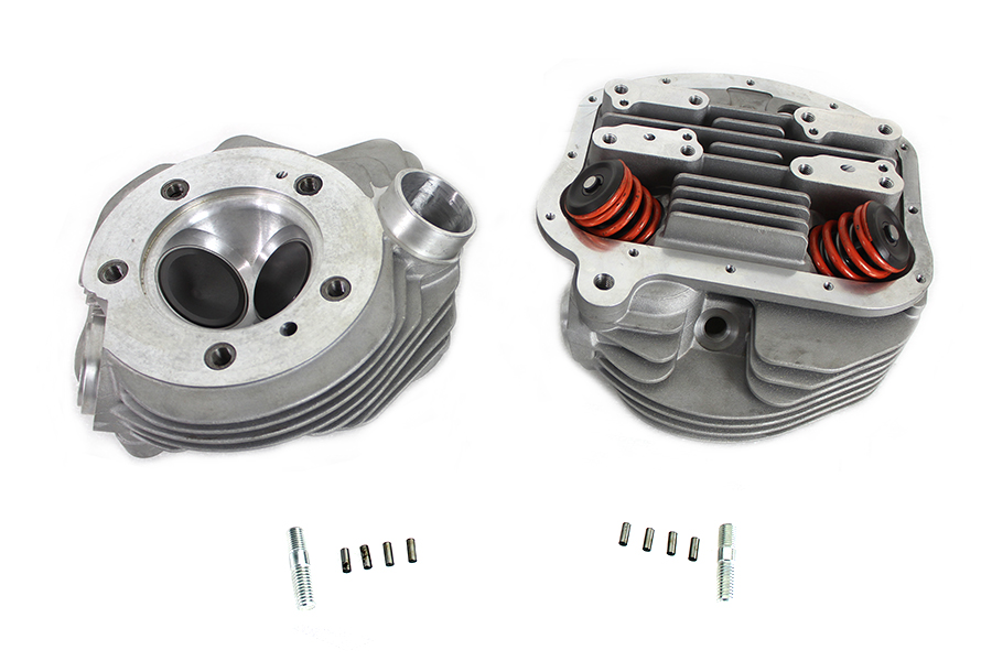

What are the current aftermarket head options? I've not kept track lately.
The today's gig that adds some Gitty-up-go to the old Pans is the up-grade to the Shovel ports ...
Gone is the T manifold and clamp on pipes ...
They also have the Shovel combustion chambers with the 1-15/16" Shovel intake valves, also has the 75-up 3/4" reach spark plugs in play
But, there's always a "BUT" .... Ya gotta run Shovel jugs with em ...
Stock heads are available for use with the Oem Pan jugs .. Plumber or O-ring ...
S&S makes a Kick-Ass set of heads that retains the Panhead look, uses Shovel rocker arms that allows for oil up the pushrod oiling like the Evo's has ... But ... There's that dang "BUT" again ... :mad:
The 48 to 52 models don't feed oil to the lifter blocks .. 53-up would be a piece of cake with using the S&S P-Series heads ..
Have seen some Folks that will drill the early case to break into the oil port feeding oil to the top end and use 53-up tappet blocks .... That's a bit of work to do, but can be done ..
If the Shovel jugs are used in order to use the up-grade heads, you would need to use the 61-up heads that have outside oil feed to the top-end since there is no drilled oil port in the Shovel jugs like the Panhead jugs have ...
Hmm. How good are the stock repro heads? It would be interesting to retain a plumber intake for looks if it will seal reliably (I'd use quality Rectorseal dope or perhaps Hylomar unless there's another anti-seize/sealant that kicks more ass.) I've removed and installed a few plumber intakes long ago on customer bikes with no comebacks but haven't any long term personal experience riding a scoot with them. The customer Pans I worked on were just beat old choppers and nothing special so I never got to get deep into studying them. This will be educational fun.
