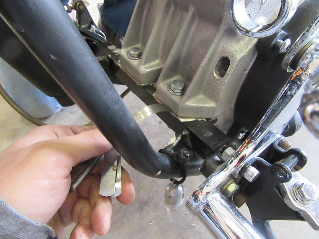

The next thing I did was check the gap under the front motor mounts to see if shims are needed. They haven't been required before with these cases in this frame, but there's no reason not to check. I couldn't get a 0.0015 feeler gage in the gap so I will say we are good to go.

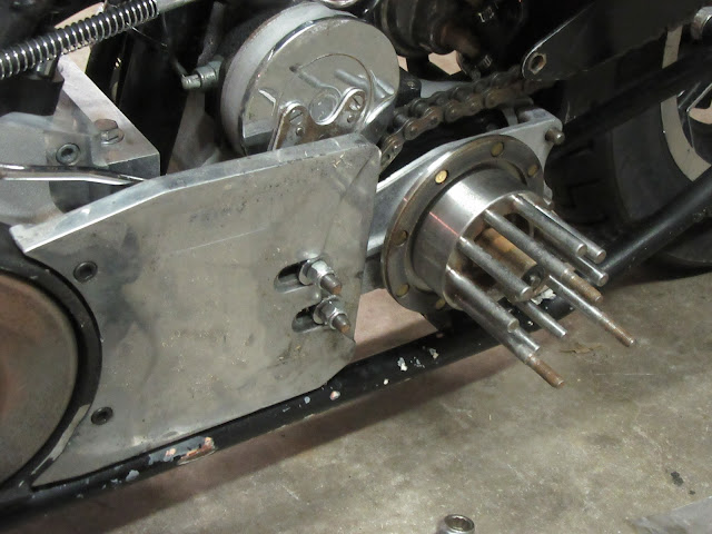

Now on to the motor plate. It's my understanding with a stock inner primary with a chain, you bolt the loose transmission to the inner primary and bolted down engine. The belt setup is different, because you have to adjust tension of the belt before you bolt the plate down tight.
We just snugged everything for now.
The top belt guard goes on before the clutch shell. We had a heck of time getting it all to line up for some reason. Then the clutch shell and the 52 long bearings.
