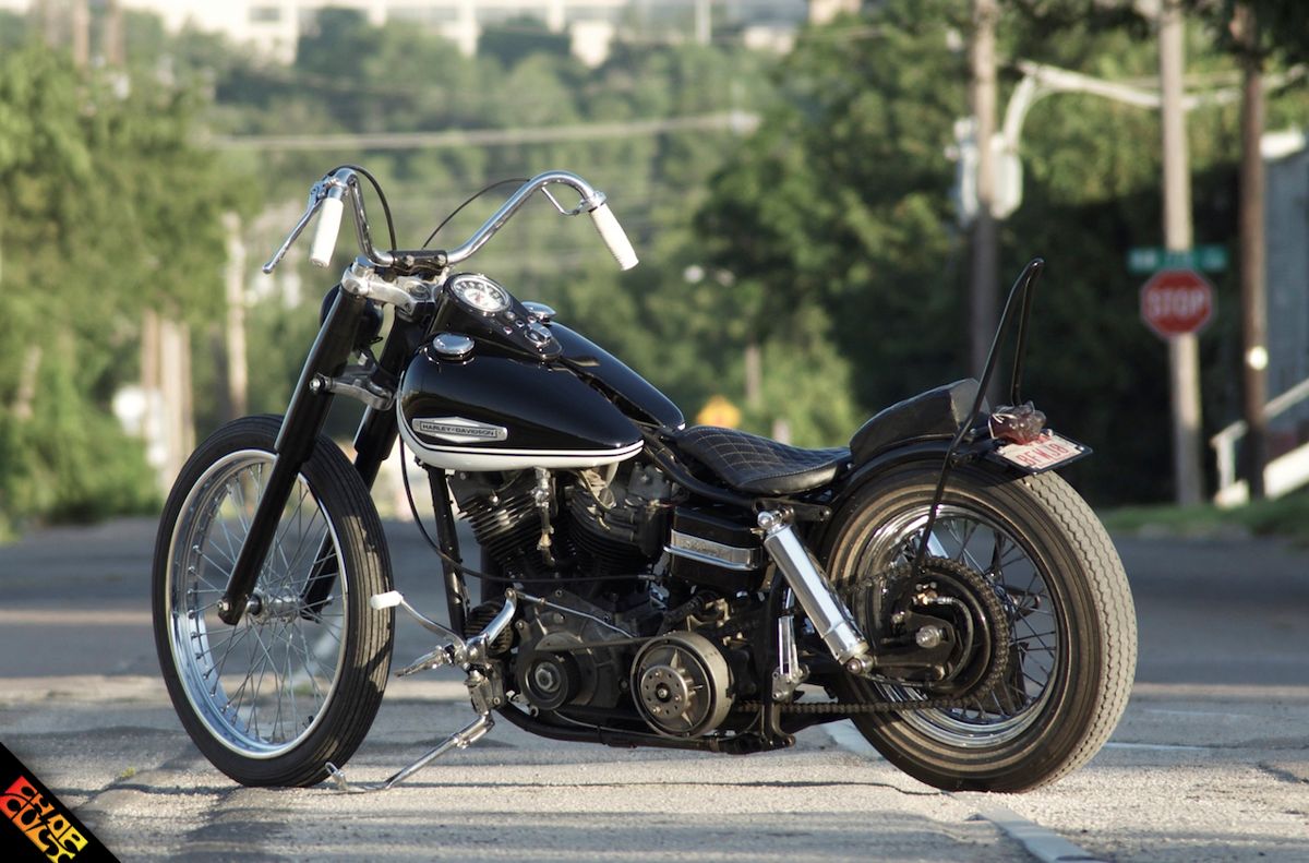

I picked up this bike off of Craiglist from a guy in Wimberley, Texas for 4,500 bucks. Although it was set up stock with some apes, pillow cushion seats, solid cast rear wheel, 5 gallon fat bob tanks, and all the other unwanted extras some dude thought was cool back in the 80’s, it was as solid as could be expected.
In the beginning, I was set on hardtailing this bike and adding a narrow frisco mounted gas tank with the standard solo seat and custom paint. I was going for a traditional 60’s style chopper look. Of course, money was a factor, so I decided to build this bike with as many parts as I could from my stash in the corner of the garage.

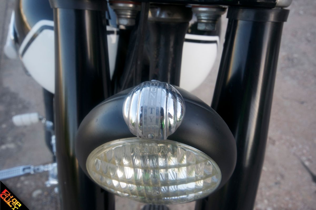

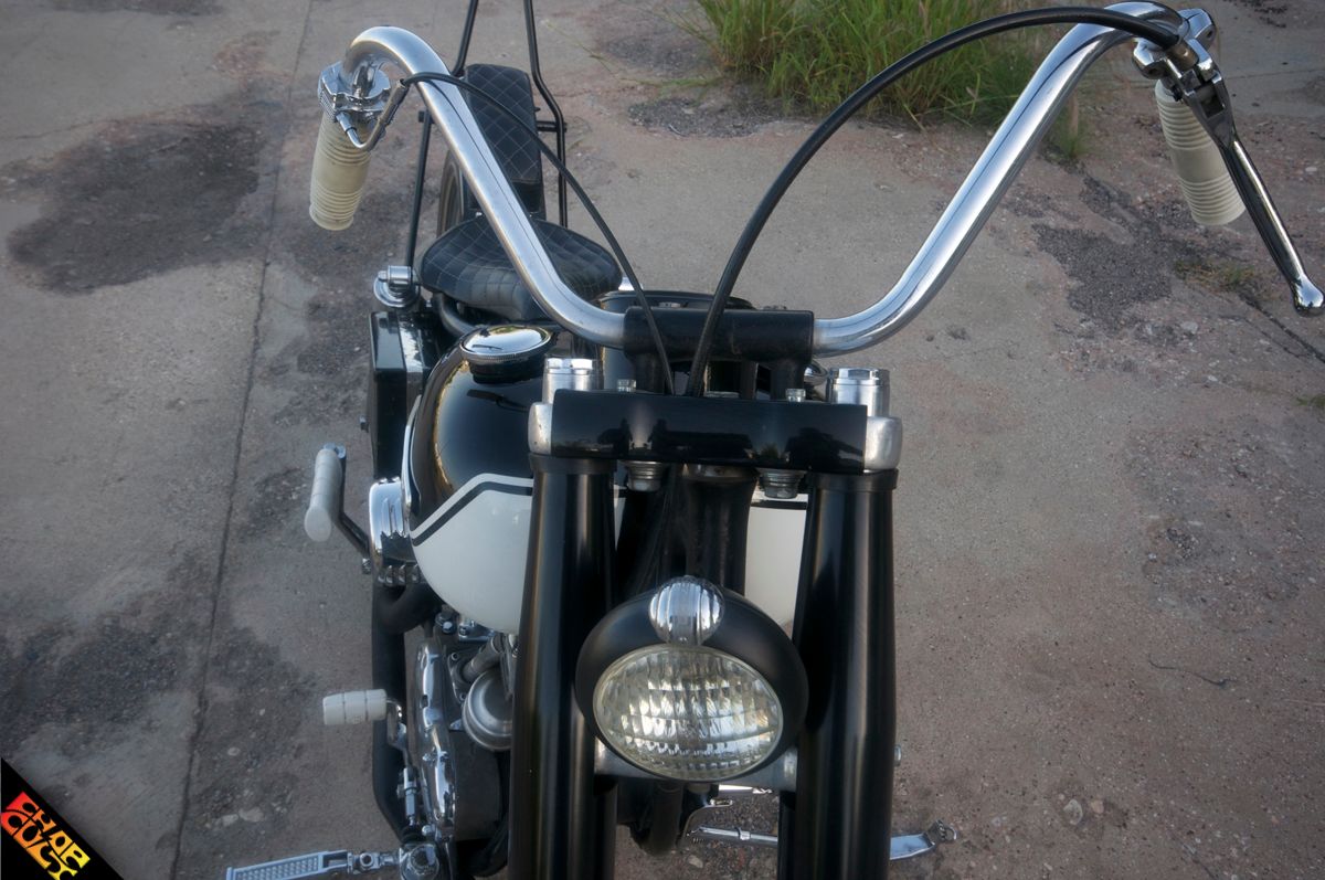

Once I completed the original plan, I sat back and was amazed how great the bike was taking shape. I decided I was not going to follow the norm, but instead build a badass swingarm shovelhead with a 60’s chopper vibe. I changed out the tanks with some old 3.5 gallon split tanks I already had and then moved on to the handlebars. At first, I decided to run some tall apes on this bike, but after mounting them I decided I wanted to use something a little different and shorter. I looked at every type of bar out there and finally settled on a pair of old buckhorns that I cut and modified. I ran an old set of split bar risers, so I cut and narrowed the bars another 2 inches to fit the look I was going for. I added a Biltwell seat pan that I had re-covered in leather and turned to Haifley Brothers for a one-off P pad. I then moved on to replacing the ugly solid cast wheel with a traditional mid star spoke wheel, added a double whitewall tire, and called it good. I decided to go with no front brake and narrow front end, so I swapped out the bulky wide glide front end with a 39mm narrow glide, added some fork shrouds from Lowbrow and cut and shaped the lower legs in my garage and after about 6 hours I achieved that clean shaved look. I also changed out the original primary with a BDL 1.5 open belt setup to narrow up the bike some. The last thing on the agenda was to have my good friend Gary Queen, owner of Other Side Customs spray a traditional style paint scheme on my tanks and fender to finish off the build.
I have to admit that out of all the bikes I have, this is by far my favorite bike and I am stoked with the end results. This bike has almost killed me twice now, but she always seems to spare me from any major harm. This will always be my go to bike and I don’t think I could ever part with her. She is my Puta Sucia (Dirty Whore), and she is always ready for some action. -Jason
Photography by Scott Hoepker/ Jason Ochoa
Owner name, location: Jason Ochoa
Bike name: Puta Sucia

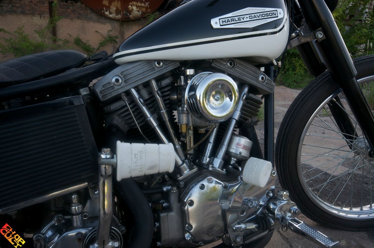

Engine, year and make, model, modifications: 1968 Generator Shovel with custom milled heads
Frame: 1973 Harley Davidson FLH
Fork: HD 39 mm narrow glide with shaved lower legs

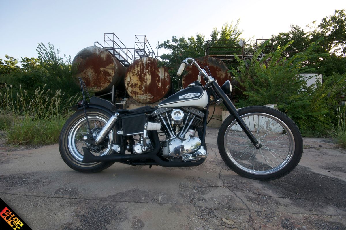

Chassis mods: Swingarm mounted fender and sissy bar, lowered 2 ½ inches and windowed neck
Tire/wheel size and style: Front Size: 21” spool hub Rear Size: 16” Mid-Star hub
Favorite thing about this bike: I like the fact that I was able to keep the classic styling without hard tailing the frame.
Next modification will be: I plan on adding some tank shift tanks and use a rocker clutch assembly.
