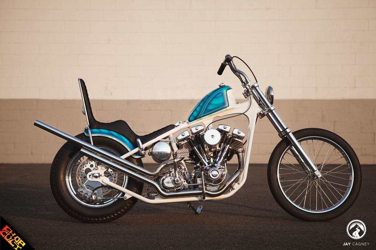

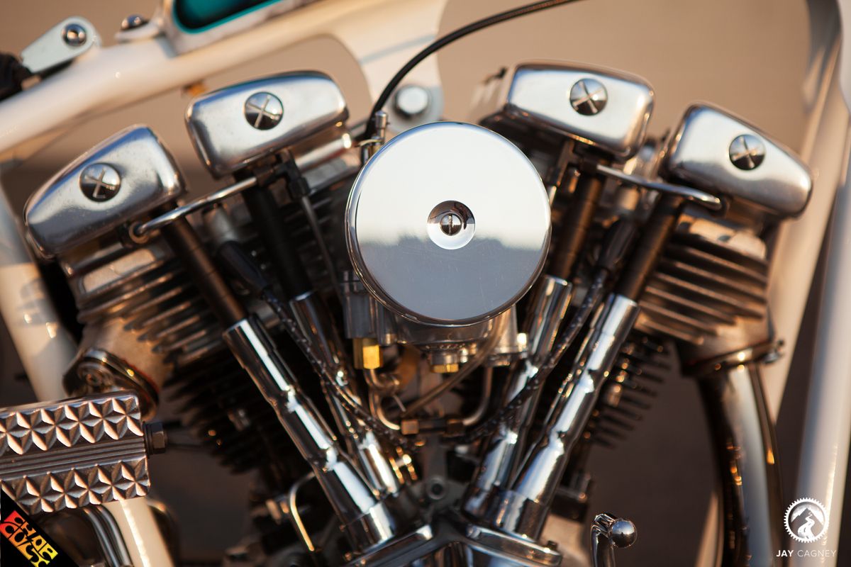

Engine, year and make, model, modifications: ’78 Harley-Davidson Shovelhead. 84 cubic inch stock bore stroker with low compression pistons. Hand split/shaped rocker boxes on dual-plugged S&S Super Stock heads. S&S 450S cam and solid conversion lifters.
Frame: Stock specs. 0” up, 0” out, 30* in the neck. Fork: 39mm HD with Mullins skinny trees and lowers shaved by Wargasser (nobody shaves them nicer than Nick!)
Chassis mods: Just some various mounts and a bunch of body filler. Tire/wheel size and style: Avon Safety Mileage rear on a 16x3” rim laced to a Wargasser hub. Avon Speed Master up front on a 21x1.6” vintage Radaelli laced to a Wargasser peaked spool hub.

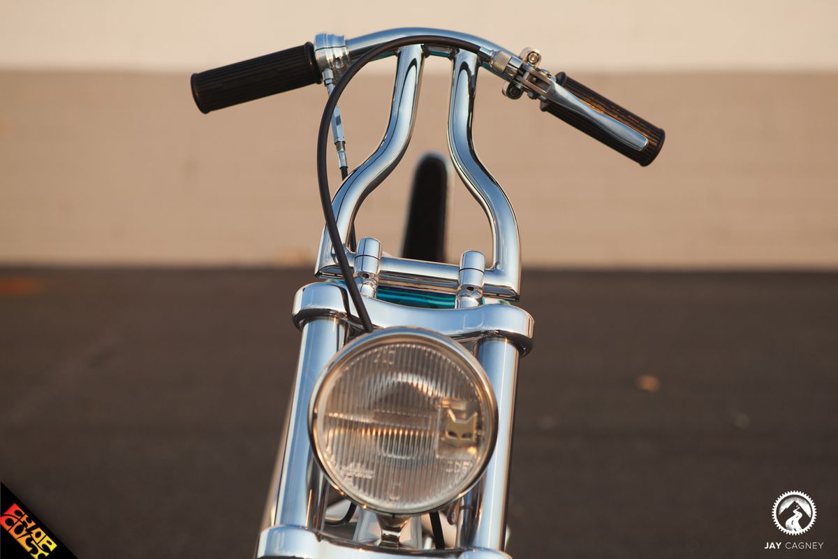

Favorite thing about this bike: Either the bars or the pipes. Probably the pipes? People hate making pipes but I kinda just love it. I feel like they add all the personality to a bike. To me, they need to say something standing still.
Next modification will be: Wear & tear. Other mods, accessories, cool parts, etc: I made pretty much everything I could myself in my tiny single car garage. No lathe, no mill. Just doing things the hard & slow way using primitive techniques. Pipes, bars, foot controls, sissy, seat, various mounts and brackets, I’m probably forgetting stuff but you get the point.
