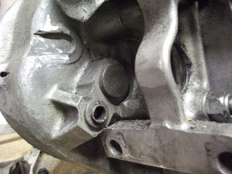

    Did a search and found nothing... I've got my next bike narrowed down to a 74 iron head with kick and an 80 iron head with no kick. Is it possible to add a kick start to the 80s iron heads?

    nope.. not possible..
    unless you have an early 80, a '79 built in jan. 1980.. or a 79 titled in 1980..
    or you get some serious work done to the cases.. '80 and '81 (early 81) have the generator still in front of the engine, newer IH's have the alternator behind the clutchhub, and right over there should the kickstarter ratchet go.
    the 79 is the last IH that could have a kickstart added.
    the cases were pre drilled and capped for the kicker shaft, the clutch hub has the holes for mounting the ratchet plate and the sprocket cover had the Master brake cylinder on top to accommodate the kickshaft.
    check the left inner rear side of the primary cases on the 80... (get my point? just check the picture)
    if it looks exactly like the picture (the cap behind/underneath the "slot" is the thing you should search for) it's an old 79 case used for the 80, and it has the holes needed for the kickshaft. all you have to do then is score a kick conversion set for a 79 (almost any year will do) and a 79 sprocket cover.

    I think the kit is about $200, and that does not include machine work

    The pipes may be in the way of the kicker anyways, hard to tell in the pic. If having a kicker is important, make sure this bike will accept it or wait and get one with later. I think that would wear on you mentally over time (it would me). If it isn't important, buy the bike and ride it. If the cases accept the kicker, it is really easy to install, you can do it in a few hours no problem.
